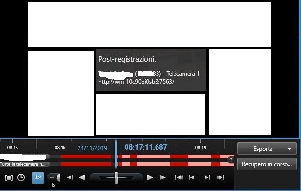

Hi,Bo
I noticed that when the problem occurs on the smart client at the point of interruption I see the writing post registrations
Yes, this explains the issue.
I will try to investigate why the MIP SDK based export is less robust than the Smart Client export.
