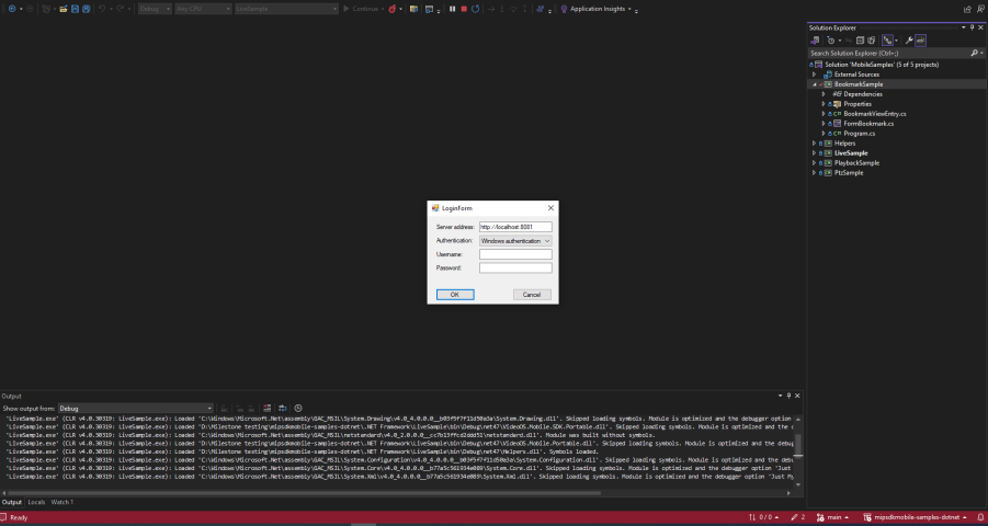

When I run the BookmarkSample in MobileSamples project in mipsdkmobile-samples-dotnet repository. it opens a LoginForm. The form has 4 fields: Server address, Authentication, Username, Password as shows in the attached image.

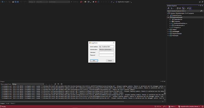

When I click OK after adding credentials I shows the Error “Not loged in to the surveillance server” as shown in the attached image.
First please do a quick test, using the web client on the same PC, can you login with the same credentials?
The test will show if you have a general issue or it is an issue specific to the sample..
Thankyou for your time. The issue resolved by adding the basic user to administrator group.
