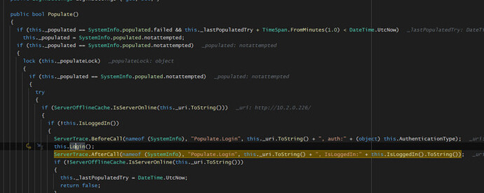

I wanted to ensure I could reproduce this, when I tried to follow your steps having two servers running. Connecting to both (with different credentials) and connecting to a camera. Then I shutdown the server I’m not connected to and choose another camera. But I don’t get the delay. Can you supply my with sample code which gives the issue?
I did a minimal sample that I thought would give the problem but it did not. I am attaching the code so that you can get an idea of what I am doing. It is hard to see what is causing the problem in my main application. I dont initialize any playbackcontroller in my minimal sample and I view much more cameras in my main application. There are probably other differences that I can’t think of right now.

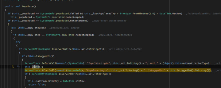

What I can see it that UI thread waits at Login in ServerInfo.Polulate with server info pointing to the failing server. This is done even when connecting to a camera at any other, working server. Attaching a screenshot so you can see exactly where in code I am refering to.
Its even harder for me to replicate it as I don’t have the same setup as you do. Would it be possible take your main application and strip down to figure what component is causing this? It sounds like its some combination of imageviewer and something else. This would also explain why I’m not seeing it in my test application.
