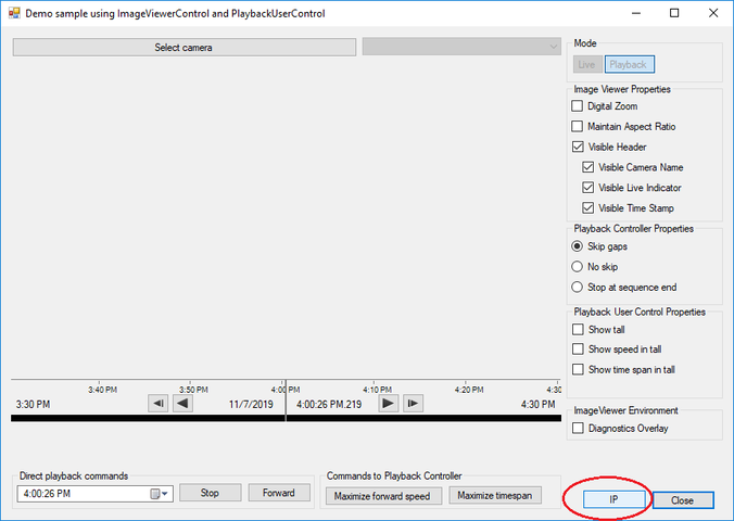

There is a IP button in the PlaybackUser sample, please explore the sample.
As i said ive looked at this example. But this is a standalone component?

I tried to rewrite my code using the exact code inside the Playback example. Before i got the message that should return the IP, but the data part were null.

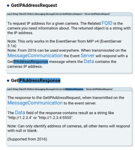

Forgive me if I’m misreading your sample code here as I’m on mobile, but I see you sending two messages - one of them is the correct message - a GetIPAddressRequest. But shortly after, you send your own GetIPAddressResponse message which I don’t think is your intention?
Later, you register a receiver for the GetIPAddressRequest message when what you want is to register a receiver for the GetIPAddressResponse message - and you want to register a receiver for that message before you send the request.
I suspect you’re actually catching your own message - I’ve done that to myself before.
I realize you’ve probably already read this part of the manual - I’m just posting a screenshot of it here for the benefit of others. What we need to do is register a receiver for the “response” message ID, and then send a message using the “request” message ID.
A​ null Message.Data value suggests to me that the software was unable to translate the FQID to an IP address (camera not found by FQID) which would be unusual, or more likely that somewhere you’re accidentally sending that message with null data to yourself but expecting it to be the message from the server.
