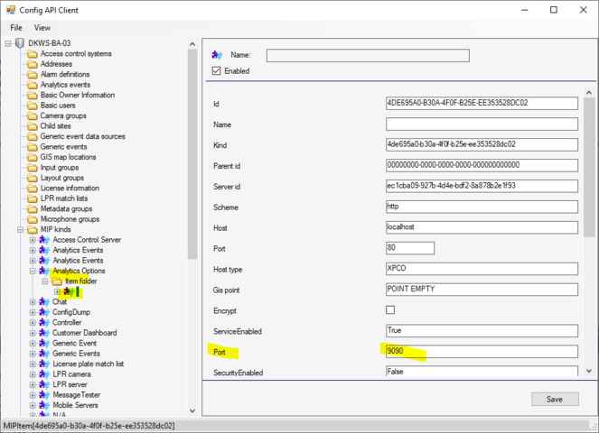

I guess the issue is that there is no sample showing pure protocols on this, only this explanation: https://doc.developer.milestonesys.com/html/index.html?base=gettingstarted/intro_configurationapi.html&tree=tree_4.html
And the option to see the structure of it using the sample:

When we can find the information using the Config API Client sample we can find the same information if developing an application using the Configuration API.

It does not look right, what was the request you made to ConfigurationApiService.svc?
I think you must make several requests letting the service lead you to “MIPKinds”, “Analytics Options” etc.
I think I understand now! You think the answer should be in ServerCommandService GetConfiguration. No, sorry. The Configuration API is another service..

/ManagementServer/ConfigurationApiService.svc is a SOAP service but unfortunately there is no sample using it direct, Config API Client uses a proxy generated from the SOAP service but this is as close as we get.
PS.
The response you posted is not Configuration API but Server Command as you can see in the response “<GetConfigurationResponse xmlns=“http://videoos.net/2/XProtectCSServerCommand””
