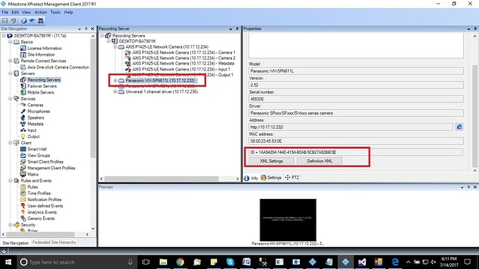

I am performing an analytics integration activity where my analytics software will require the GUID of the cameras added in Milestone to be able to use the video streams from Milestone. I have explored the MIP samples but unable to find how to get the GUID of existing cameras which we can generally see in the management client by clicking on any camera. Please refer attached image. Do let me know how to find the camera GUID since all I can get here is the FQID and ObjectID which would not serve my purpose.

The ObjectId inside the FQID is the GUID of the camera.
Also be aware that when sending analytics events to the event server the analytics event can use the cameras IP address as well as the guid (might avoid customer setup)
