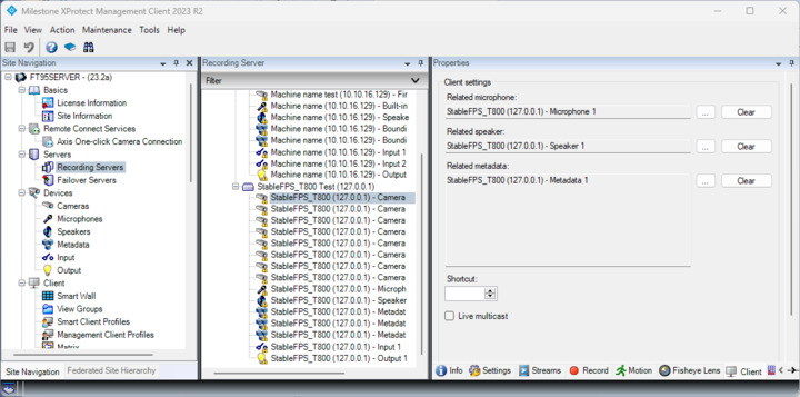

When you use cameraitem.GetRelated the answer reflects the setup as you see it in the Management Client – Camera Properties, the Client tab.
It is not necessarily the hardware that decides this as the user can change it. Per default when adding a new camera the setup will reflect the microphone, speaker, and metadata channels in the same hardware device, but it can be changed by the user after adding the camera.
Historically there was no concept of Hardware in the MIP Configuration because the Smart Client don’t use it. In the same way there is no association between a camera and the output(s) on the same physical camera hardware.
