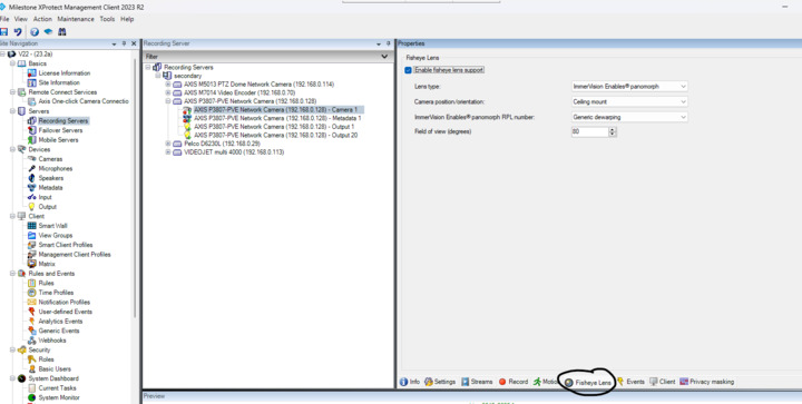

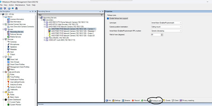

Hi,
Using 2023 R3 SDK with 2023 R2 XProtect Corporate
When using Configapi we don’t see the Fisheye lens tab to change the settings
XProtect window
ConfigAPI sample Is this not supported by ConfigAPI?Thanks,
Vega

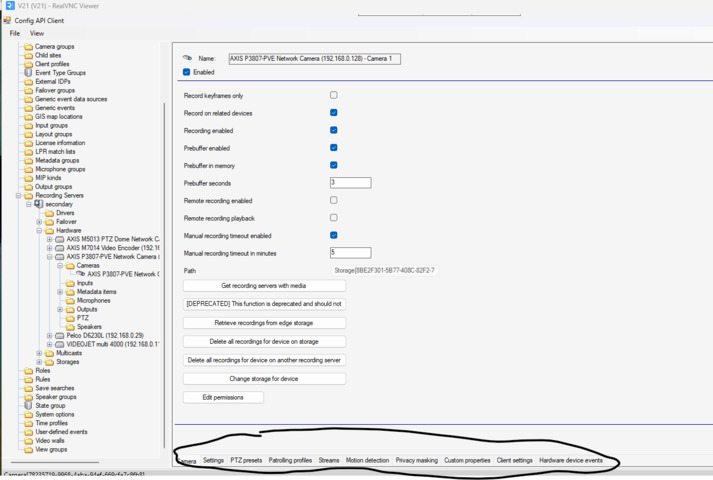

Hi,
XProtect window
Vega

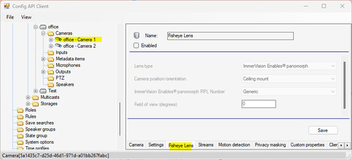

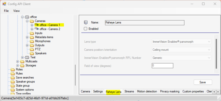

When I do the same test I do see the Fisheye Lens tab in the Config API Client sample.. (XProtect 2023R3)
typo error: using 2023 R3 SDK on 2023 R2 XProtect

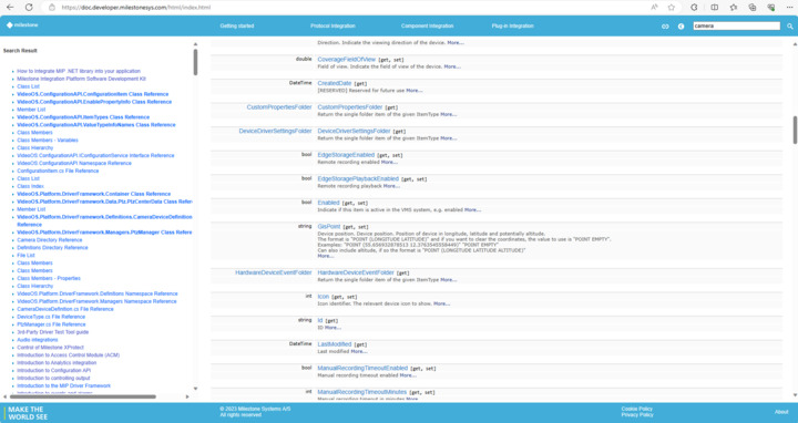

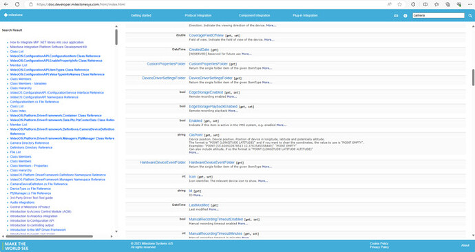

Where can we find the strongly typed name to access Fisheye lens configuration?
I could reproduce the issue with 2023R2 XPCO. But when using 2023R3, the issue is no longer there as we said in the previous comment.
I need to talk to Milestone Development regarding the issue but many developers are out of office due to winter holiday. So we will get back to you next year. I am sorry for the inconvenience.
I have talked to Milestone Development and turned out that it is not supported in 2023 R2 so that is why there is no FishEye lens tab. The functionality is introduced in 2023 R3.
Unfortunately, by mistake, there was no mention of this in the documentation that this was introduced as a new feature in 2023R3. We will make updates to the documentation for future releases.
