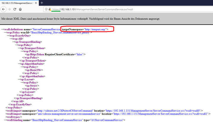

I am unable to connect the server based on the WSDL files from the SDK. If I query the WSDL files from the server itself, the namespaces are completely different. (“http://videoos.net/2/XProtectCSServerCommand” <> “http://tempuri.org/”)
Is there an explanation ? Unfortunately, I am not the WSDL specialist. And the installer of the Milestone system can not help me.

If I use the deprecated URL http://192.168.1.151/ServerAPI/ServerCommandService.asmx it workes with the WSDL from the SDK.
The new URL http://192.168.1.151/ManagementServer/ServerCommandService.svc has the wrong Namespace and don’t work.
What did I misunderstand ?
What needs to be done differently for the new URL ?
