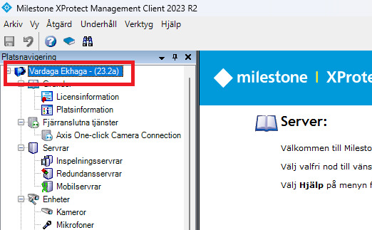

How can you get the site name in an event server plugin (as specified in the management client)?
You can use -
Item siteItem = EnvironmentManager.Instance.GetSiteItem(EnvironmentManager.Instance.MasterSite);
The item you get is the “site” item and has the name corresponding with the property you have highlighted in your screen capture from the Management Client.
