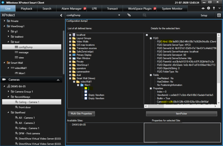

I have done no testing with the very old version. Testing with the new version I get the result that I expected. See this screen capture where I use the Config Dump tool plugin sample to examine the items hierarchy:
I have a suspicion that there might be small changes that could break your coding as I found this: https://developer.milestonesys.com/s/article/changes-to-Smart-Wall-in-Smart-Client-MIP-plug-ins
I hope you can use the tool sample as I did and do corrections and solve the issue you have.
