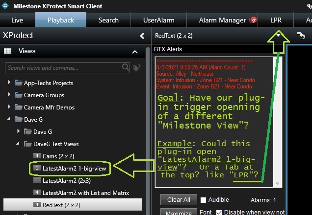

Just to be sure. What we would like is:
Have our plug-in in the open view: ‘RedText(2x2)’ open different view
as if the user clicked on the view on the left side … such as ‘LatestAlarm2’ circled in green.

I believe my answer is correct. It seems you have a graphics here that I cannot see, I see a .jpg text. If you have tried the sample and have a picture that could help me understand what you observed please try again to update and let me see..
