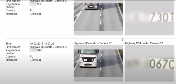

Hello. I want to know if it is possible to generate and sav reports using MIP SDK.
For example, plate readers reports with a list of plate recognition events and associated photo.
