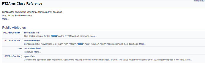

Hi everyone, i am using the PTZMoveStart function for focus property and we need to know what are the values for focus?? in the following link, we got the values for zoom, pan, tilt and iris, however we didn't see the values for focus.
could you please help us??
https://doc.developer.milestonesys.com/html/RecorderSOAPhelp/class_recorder_command_service.html#ae6a20c19988b3404f4b36c8dded19511
https://doc.developer.milestonesys.com/html/index.html?base=miphelp/class_video_o_s_1_1_platform_1_1_messaging_1_1_lens_command_data.html&tree=tree_search.html?search=focus
Hi Andersen, thanks, i am using the PTZArg object and the value for the focus property is Double. can you please give me an example??
I see how my first answer was not a good fit.
I have discussed with colleagues and we think FocusFar will be +1.0 and FocusNear will be -1.0. Unfortunately I have no way to test this theory right now, can you please try to test this?
