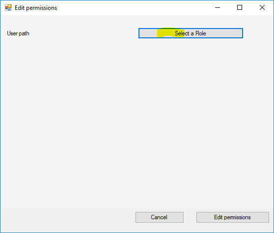

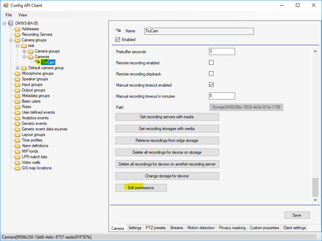

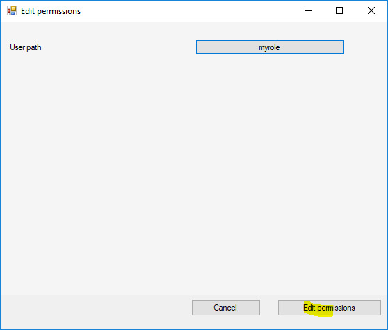

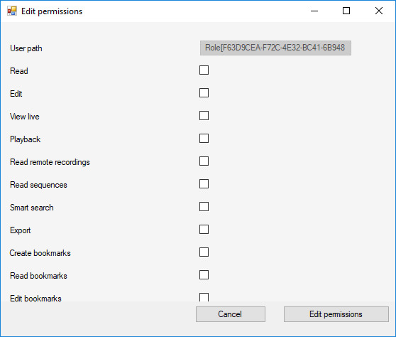

Let me illustrate how this looks using the Config API Client sample:

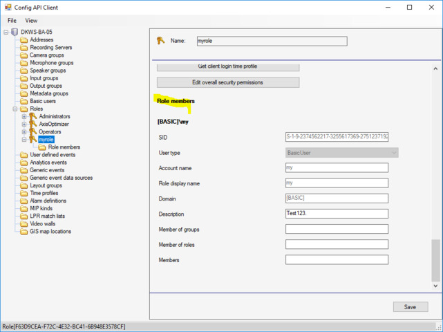

and in same sample find users on a role
