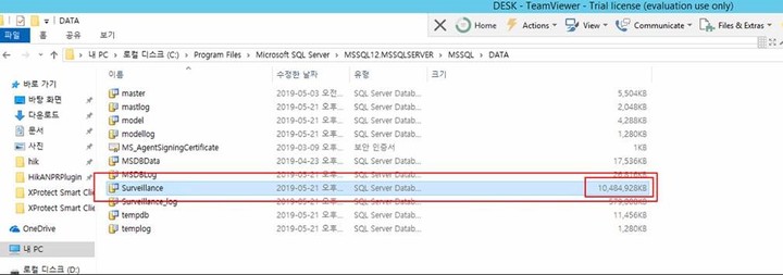

There are two problems. First, we can’t receive real-time alarm on developed tab(which insert on Smart Client ourselves), because the plated is full of limited sql database of Milestone(about 10G). Second, we can’t search data.
We know Milestone provide about 10G database for free, if we need more storage, we should buy service from Milestone. The issue is when the 10g database if full of plate, wired problems happened.
The database is full now, then we can search nothing by API of MIP SDK.

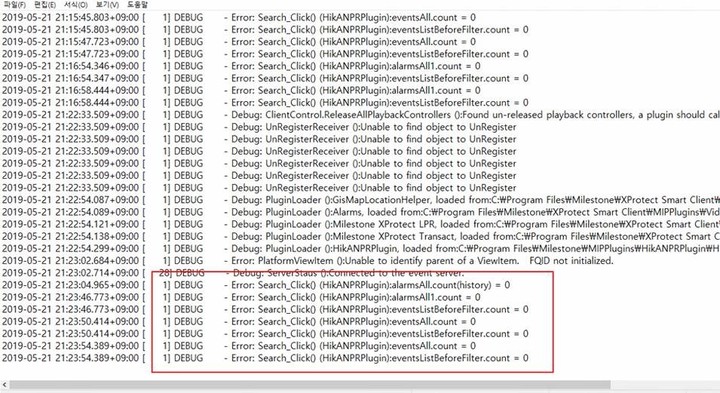

2. We can’t search history, because we get 0 after call corresponding API of MIP SDK. The following is the log.
The following is the code which used corresponding API:
code1

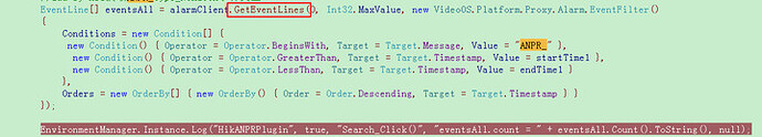

API of MIP and print log is here:
                             EventLine\[\] eventsAll = alarmClient._GetEventLines_(0, _Int32_._MaxValue_, new _VideoOS_._Platform_._Proxy_._Alarm_._EventFilter_()
                           _Conditions_ = new _Condition_\[\] {
                             new _Condition_() { _Operator_ = _Operator_._BeginsWith_, _Target_ = _Target_._Message_, _Value_ = "ANPR\_" },
                            new _Condition_() { _Operator_ = _Operator_._GreaterThan_, _Target_ = _Target_._Timestamp_, _Value_ = startTime1 },
                            new _Condition_() { _Operator_ = _Operator_._LessThan_, _Target_ = _Target_._Timestamp_, _Value_ = endTime1 }},
                           _Orders_ = new _OrderBy_\[\] { new _OrderBy_() { _Order_ = _Order_._Descending_, _Target_ = _Target_._Timestamp_ } }
                       _EnvironmentManager_._Instance_._Log_(false, "ANPR\_", "Start: " + startTime1 + "End: " + endTime1 + "Ret: " + eventsAll._Count_(), null);

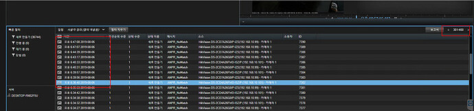

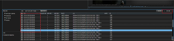

 From the print log: we can see data of 5th August is empty, no date return from server. But in fact, we can see many alarms on Milestone original tab “Alarm Manager” in 5th August.
(picture 1)
At present, the missing data including (after 6:36:40 of 6th August), and all data before 6th August.

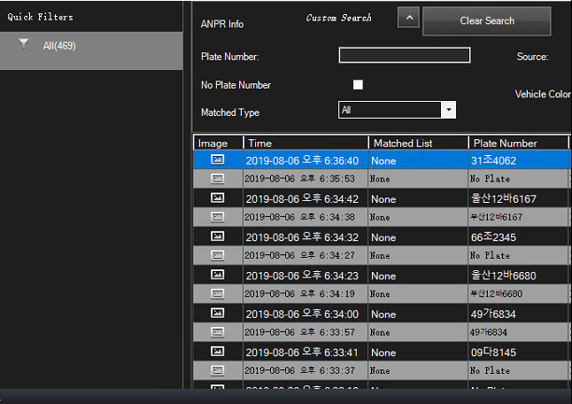

Above all, there is data in Milestone database, but we can’t search part data via MIP API.

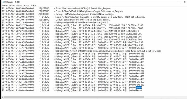

picture 2: Hikvision plugin tab, data missing)

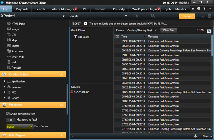

(picture3: Milestone original tab “Alarm Manager”, data exist)

(Please note: we confirmed Milestone database is not full)

picture1: print log
picture2: Hikvision plugin tab
picture3: Milestone original tab “Alarm Maneger”

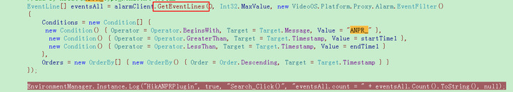

We have new question: When acquire data from database, we should input filter, if we use the following filter: EventLine[] eventsAll = alarmClient.GetEventLines(0, Int32.MaxValue, new VideoOS.Platform.Proxy.Alarm.EventFilter()
                                 new _Condition_() { _Operator_ = _Operator_._BeginsWith_, _Target_ = _Target_._Message_, _Value_ = "ANPR\_"}},
In theory, Milestone should return ANPR_xxx (xxx means suffix). But in fact we get ANPR Started,ANPR Stoped… You can see it from the following screenshot.screenshot

  1. Events and Alarms have different retention setup. When you use alarm display in the Smart Client it does not say whether there is still an event. You can get the Smart Client to show events instead. Create a view with the Alarm List, in setup mode change the Properties -Data Source to Events.

Hi,
the underscore character in “ANPR_” is interpreted as a wildcard by the data store engine. Therefore, querying for “ANPR_” returns the same value as querying for “ANPR”.
You can use the wildcard pattern matching characters as literal characters. To use a wildcard character as a literal character, enclose the wildcard character in brackets. The table shows several examples of using the LIKE keyword and the [ ] wildcard characters.
So for this particular case the pattern used should be “ANPR[_]”.
