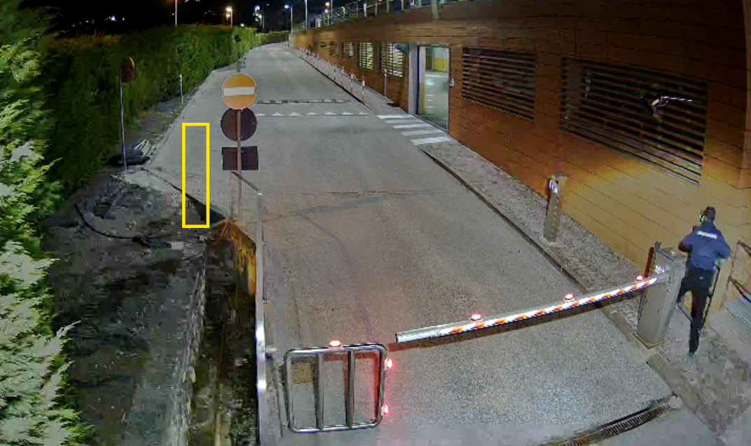

I have a system with about a hundred Hikvision DS-2CD3646G2HT-LIZS cameras. These cameras are configured for perimeter intrusion alarms detections, so the metadata is generated when an intrusion is detected that meets the camera’s defined criteria. These events then triggers alarms in Milestone.
In both live view and recordings I have a misalignment between the yellow boxes that define the intrusion event and the actual intruder in the video stream:
As you can see, the yellow squares are always misaligned, they are always shifted to the left and up. The system is aMilestoneExpert 2023 R3, and the cameras are configured with the driver “Hikvision Generic”. The time of the cameras and Milestone are the same….

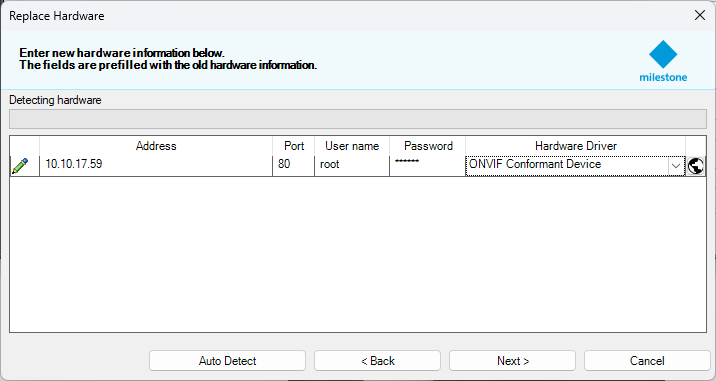

I find that the camera should use the ONVIF Driver. Try to replace the driver for one camera and see if it makes a difference. In the Management Client- Servers- Recording Servers, pick the device, right–click -Replace Hardware. Leave values as they are except the Hardware Driver.
Please let us know if it makes a difference.

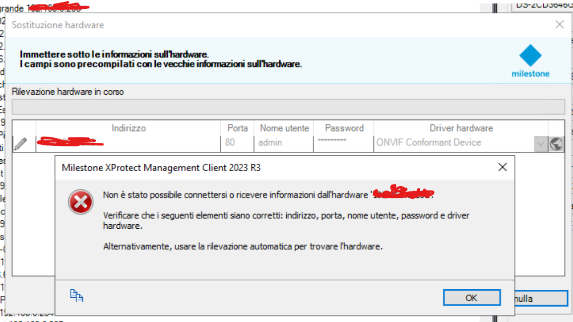

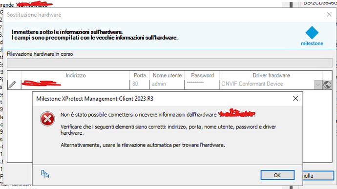

I’ve tried also to switch driver on a camera affected by the problem, but it doesnt allow me to proceed with the ONVIF driver, it says that it cannot connect to the camera:
if i try with the auto detect procedure, it wants and autoselect the “HikVisionGeneric” driver…
EDIT:
Sorry,
the user password was wrong, my bad :slight_smile:
i’ve changed the driver in the onvif one, the camera works, but now i dont see the yellow squares at all… the camera is configured to detect human and vehicle intrusion, trough the “SMART event” function on the camera… its not a “simple” detection event, so i presume milestone wants the hikvision driver to “read” properly the metadata generated?
