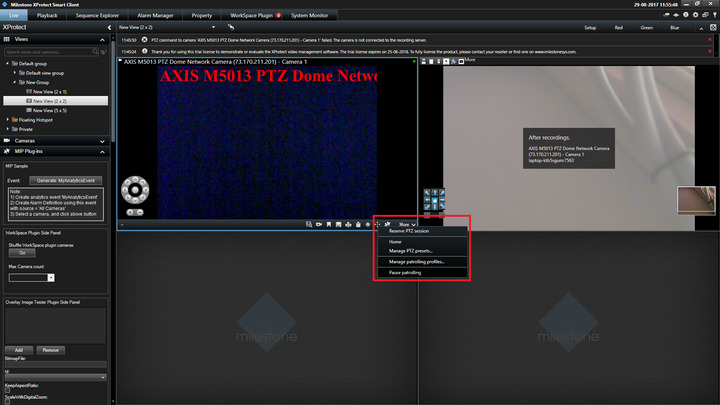

How Can I achieve full functionality of PTZ in my Own ImageViewerControl in my plug in
How can I achieve Whole PTZ capabilities as shown in the below Image in my own _imageViewerControl which is been used in my plugin
Unfortunately these PTZ actions are not open for MIP plug-ins. What is open you can see in the PTZandPresets sample.
