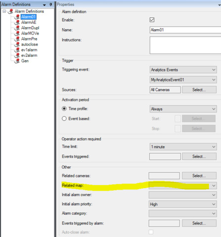

When you make an Alarm Definiton you can set an related map for the alarm.
PS. As it is right now you cannot create Alarm Definitions using the MIP SDK , Alarm Definitions will have to be created manually in the Management Client.

In the MIP SDK 2018R1 coming shortly you can now work with time profiles, user-defined events, analytics events and generic events in the Configuration API. This a step towards also being capable of supporting alarm definitions. Alarm definitions will be added later but right now there is no schedule which can be announced.
