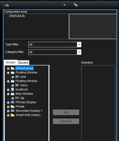

Perhaps you can use one of the indications as trigger for an investigation. When triggered investigate whether you have the same views as before. To understand what view exists you can use the configuration. Here I will point to another tool plugin sample. With the Configuration dump sample you can in the Smart Client see what views are open.
This sounds good. I will try this. As tigger I can use “SelectedCameraChangedIndication”.
Solved, if I get a new Alarm I check if window is open. This meets my needs.
