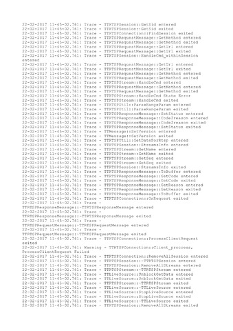

In the RTSP log message, I found the message like below
“Warning - TTRTSPConnection::Client_proccess, ProcessClientRequest Failed”
-> What mean?

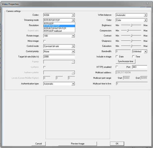

I couldn’t stream in the beginning aswell but this worked for me:
Make sure the camera’s streaming mode is set to RTSP.
Bigger pic: http://i.imgur.com/qpGG1JW.png
Live RTSP stream does work for the ONVIF bridge. However, the camera must be running H.264 (as is also stated in the documentation). Is your camera set up for this in the XProtect Management software?
