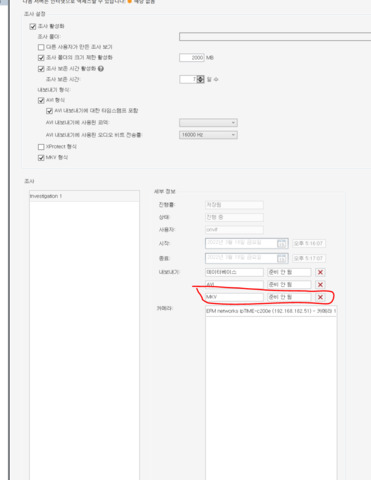

Thank you Nikolay!
​I activated MKV format follwing your advice.
However, the error code is still 23.
When I checked the Management Client, It was not ready to export to MKV
​What’s the reason ? What should I change?
Hi again,
One other reason for getting error code 23 is that you’re trying to create export before the corresponding investigation was fully done.
Can you please confirm that your investigation is already in Saved state by the time you’re initiating the export?

Progress (first item) is already saved.
​The status (the second item) is in progress.
​And I confirmed that the investigation I requested was stored in the investigation folder.
