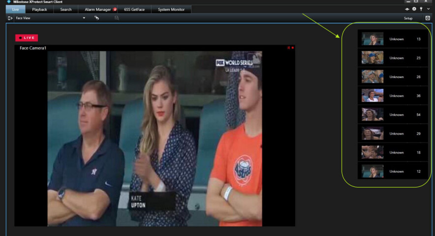

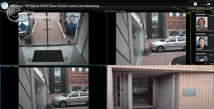

I’d like it to look like the attached images below.
or

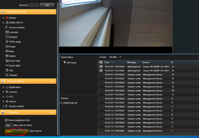

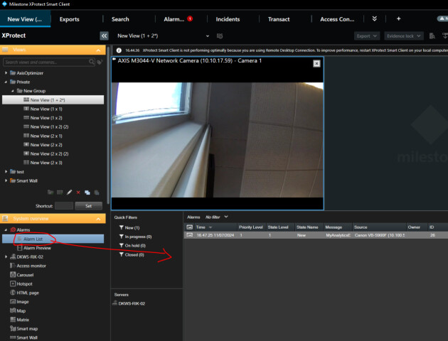

I am wondering if you have tried normal Smart Client functionality. It is possible to see Event List on Live view without any integrations. Let me write down how to do it.
Start Smart Client and go to Setup mode.
Create a new view and drag and drop Alarm List to the one of the viewitems.
Select the Alarm List in the viewitem and go to properties. Select Event. If you want to see Alarm list, please select Alarm.
Escape from Setup mode.
Then you will see all the events in Live view.
If you drag and drop Alarm preview to another viewitem, then you will see the event preview recording (if there is recording) when you click one of the events on the list.
Thank you for your reply, but it seems uncustomizable. We would like to display an image and several custom fields, which the function above doesn’t include. Do you have any ideas?
