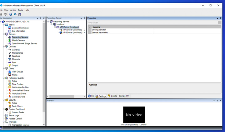

I have checked and there is a data folder for FPS that contains your default sample videos, but for some reason my VMS is stating that it is “disconnected” from the virtual demo camera.
Please note, I am doing all of this on “localhost.” See the below screenshots.
When using Staple FPS most of the settings you need to set are on the device level not on the camera level, so on the last screen capture go one level up and see if you have filled out the appropriate settings.
If the settigns looks right to you but you still do not get working video, please show this in a new screen capture, I might be able to detect if something is missing or wrong.
Thank you. I am attaching two screenshots of the “settings” tabs for the VPS Driver and the camera. It does not look like my settings are configured, but I am unsure how to configure them.
(The first screenshot is in this reply. The second screenshot is in the next one. I can only attach one screenshot per reply.)
Second screenshot
I misunderstood, I thought you had a device already using Stable FPS driver, but this is a device for VPS using VPS driver. (Maybe the name should have been a hint for me on this.) So this is not a device using the driver. It is unclear to me if you thought it was or if that is only a misunderstanding on my part.
