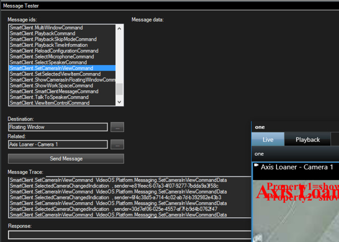

I wonder if what you need is the SetCameraInViewCommand -
const String VideoOS.Platform.Messaging.MessageId.SmartClient.SetCameraInViewCommand = “SmartClient.SetCameraInViewCommand”
I can see this working using the Message Tester tool plugin sample..
When I try testing in the Message tester Item picker for destination it shows only the camera but not the windows as you mentioned.

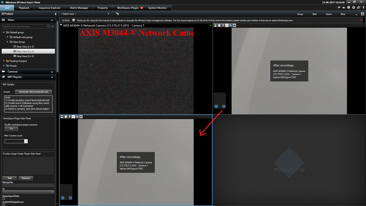

Ok I will explain my scenario

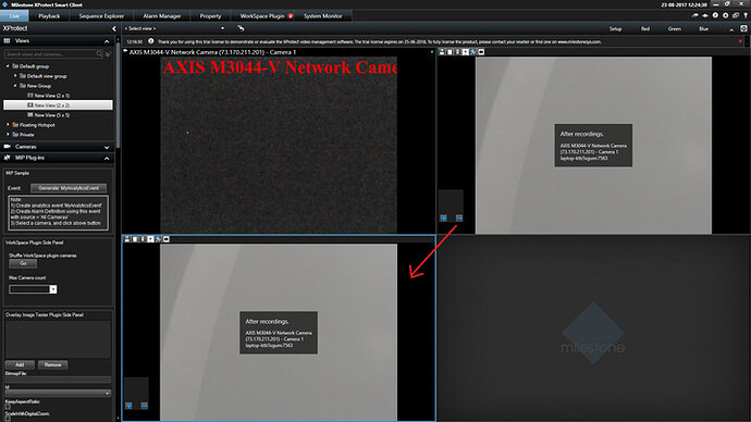

1.I have View like below which is highlighted in red.OurImageViewer

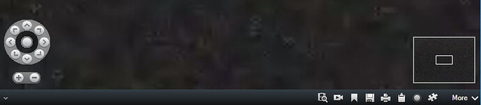

Now I have set the functionality in More button to send
1.Floating window like below but how can I achieve this and even I want to retain n the selected view like the same how it happens n the normal control ?
2.Send to multiple view.
I want to send my cameraViewcontrol with customized toolbar to other index of the same view.
And also please let me know how can get same icons used in the tool bars of milestone.

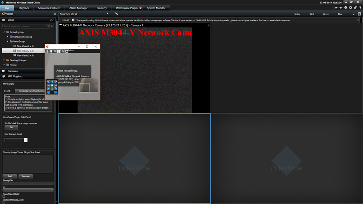

What you show on the graphics is not a floating window, or not what we in Milestone call a floating window. When using your own pop-up window like this it should be possible to control it like you wish. Can you explain what is stopping you?

The icons are part of the Smart Client and not in the MIP SDK.
If you want not only icons but also the functionality I have to disappoint you, the icons and functionality will only pertain to camera-view-items.

Yes I know its not floating window.I just created it to show you that we want output in floating window with all the control visible in the view.Is there any way to achieve it?

  1. my doubt is it able to achieve the way I have shown below with all the controls present in the ImageViewerControl?
