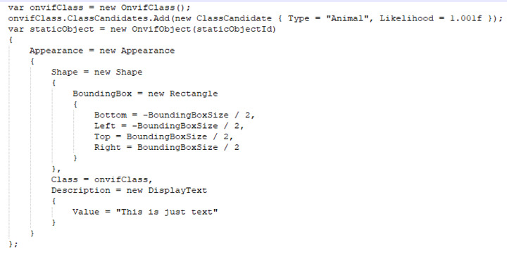

You need inject OnvifClass into Appearance object as Class as below:
You can read here to learn more about the topics. The MetadataLiveViewer sample can be used to verify the ClassCandidate data is sent.Hi Nur , Thank You For the answer, it worked!
