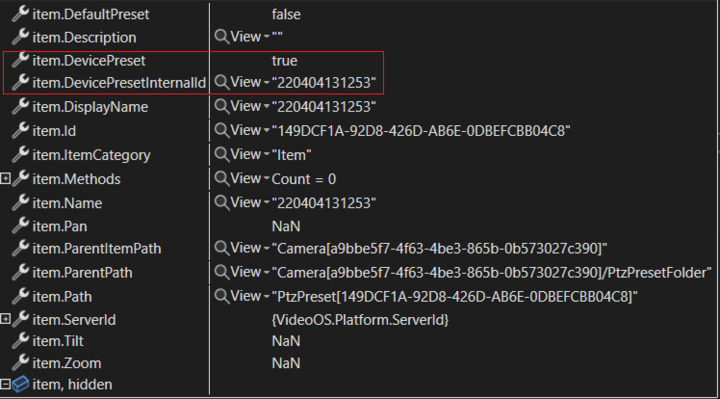

How I can change in PtzPreset Class properties:
DevicePreset to true
DevicePresetInternalId to preset Id on camera.
Whitch function I need to use?
Or how to use “PtzPresetFolder.GetDevicePresets()” from SDK
