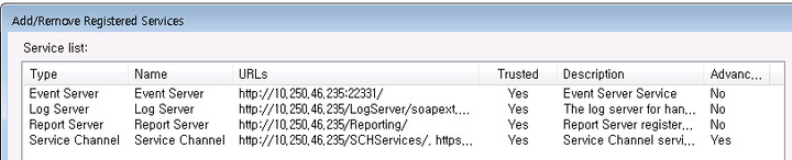

- I cannot find the how-to using the Management Client 2017 R1
- The registered Services like below
