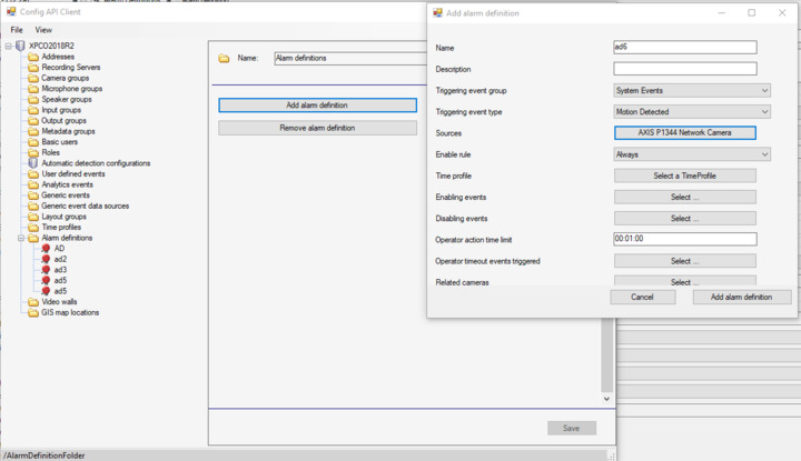

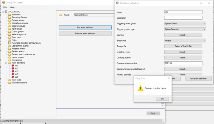

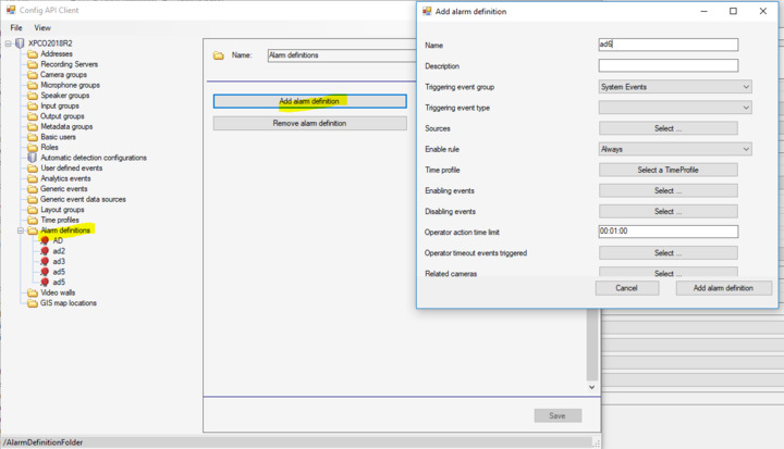

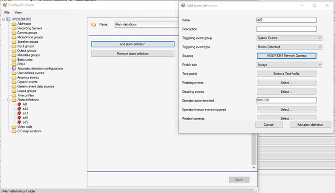

When doing the same in the Config API Client sample
I notice
-when I switch [Triggering event group] from System event to something else and back I get the “Triggering event type is out of range”
-depending on the choice here the [Triggering event type] drop down is populated with different list of objects
-when I switch [Triggering event type] to something I get “Sources is out of range”
-when I use the select button and get the [Sources] right there is no error, I am able to use the Add alarm definition button and create the alarm defintion
Learning from this: So depending on how you do this you will either get errors while building the right command data, or if you fill the whole you will have to be very careful what you fill into the data set.

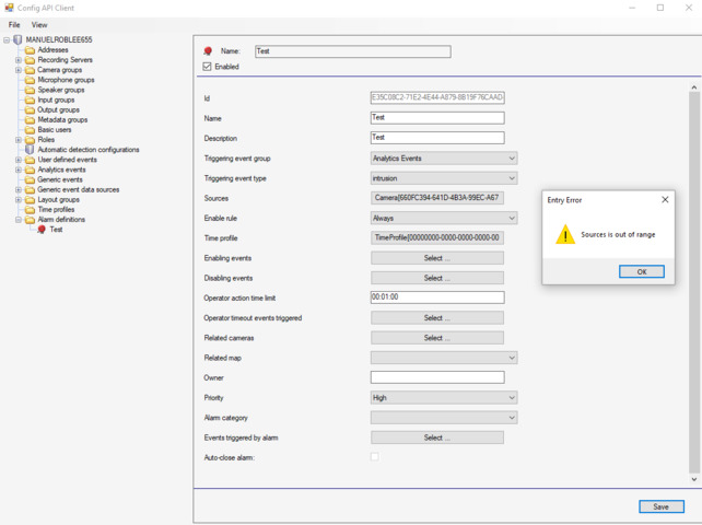

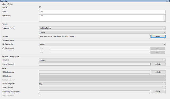

The strange part is that I can create an Alarm Definition just fine with the Management Client like that:
I can also load this newly created alarm definition with the Configuration API client. However I cannot save the alarm definition with the config client, even if I don’t change a single property. Same error as in my code: “Sources out of range”.
I can save it, if I change the triggering event from an analytics event to another event type like System Event / Enabled. But I can never save anything if I choose “Analytics Event” as event type - always the sources are out range. Also when having chosen an an analytics event the member picker tree view for the sources property is not populated - as in there is nothing valid to pick. It works just fine and shows e.g. my cameras when having picked “System Event”.

I am reporting this to Milestone Development as a bug. I will update here when there is news to tell.
A fix has been developed for the issue you have experienced here and this fix will be included in the XProtect 2018R3 with expected release on October 2.
