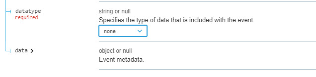

So where to define this payload for that user defined datatype ?
@Naresh Anga​ right now, custom payloads are not accepted in user defined events.
First, `“datatype”: “UserDefined”,` is not a documented or supported datatype. In the docs you will see that in R2 only none and analytics are supported.
User-defined events won’t support payloads in coming releases either. We are working on improving support for user-defined events but cannot commit to anything yet.
If you need to attach a custom payload / data to the event, you have two options:
  • use either datatype analytics with an analytics event (not a user defined one)
  • use datatype freeform with any kind of event type (including plugin event types defined in EVS plugins), which will be available in 23R3
