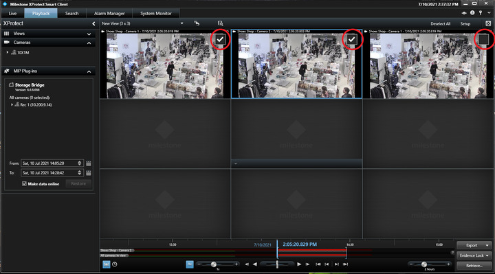

I need to get selected cameras (multiple selection, cameras ID needed) in the Smart Client playback view. Also in case there is something different in the view (not camera, plug-in for example) I should ignore it (only cameras needed).
Here (screenshot) I should get 3 cameras total/2 selected. I know about MessageId.SmartClient.SelectedCameraChangedIndication, MessageId.SmartClient.GetSelectedCameraRequest but using this I can get only the selected camera (the one with blue border) and not all checked cameras. Also I need all cameras added in the view. So the question: what is the proper way to get these using MIP SDK (.NET).

Right now we have side-panel plug-in implementation where the user should manually select cameras from camera-groups tree (in our side-panel view). After that and time selection we perform actions against cameras data (blocks) for the selected time range. Now we would like to simplify our side-panel plug-in as all these (cameras + time range selection) can be done from Smart Client playback view only.
