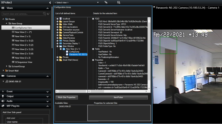

Configuration Dump sample might be helpful -
