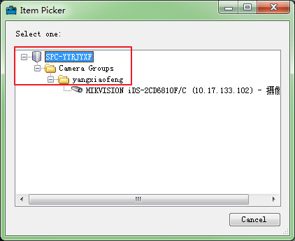

How to get the group of the camera
​Like this
but,My code can only get the list of cameras
   public static List<Item> GetCameras()
       List<VideoOS.Platform.Item> item = Configuration.Instance.GetItems(ItemHierarchy.SystemDefined);
       List<Item> cameraList = FindAllCameras(item);
       return cameraList;
   private static List<Item> FindAllCameras(List<Item> oItem)
       // ItemHierarchy.SystemDefined
       List<Item> cameraList = new List<Item>();
       if (oItem != null)
           foreach (Item item in oItem)
               if (item.FQID.FolderType == [FolderType.No](https://FolderType.No) && item.FQID.Kind == Kind.Camera)
                   cameraList.Add(item);
               if (item.FQID.FolderType != [FolderType.No](https://FolderType.No))
                   List<Item> check = FindAllCameras(item.GetChildren());
                   if (check != null && check.Count > 0)
                       cameraList.AddRange(check);
           return cameraList;
       return null;
So you need to develop a routine that can give you an understanding of the “tree” so that you know the group(s) the camera belongs to. Please explore the ConfigAccesViaSDK sample for a visualization of the tree that comprises the configuration.
