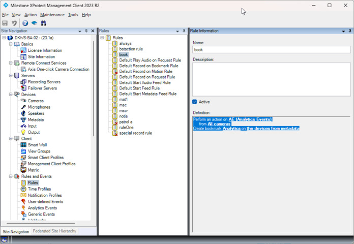

There are two ways to do analytics events and bookmarks.
Let your integration send an analytics event. In XProtect set up a rule to create a bookmark. The rule can be made in the Management Client, this is an example:
The rule can also be configured by your integration so that no manual setup is required, you can achieve this by using Configuration API or Rest API.
