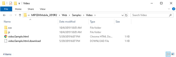

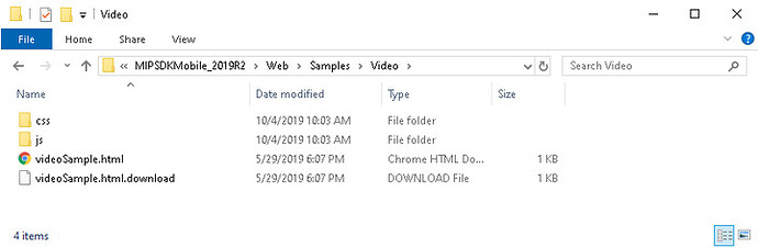

Yes, i have downloaded this folder. but the folder which i have does not contain these paths and files. there is no video folder in sample folder.
Thankyou.
When you look at the folder structure which comes pre-installed with your Mobile server there is “XPMobileSDK” folder, where web part of the SDK is put.
In the package that is externally downloaded “Samples” is directly under “Web”.
