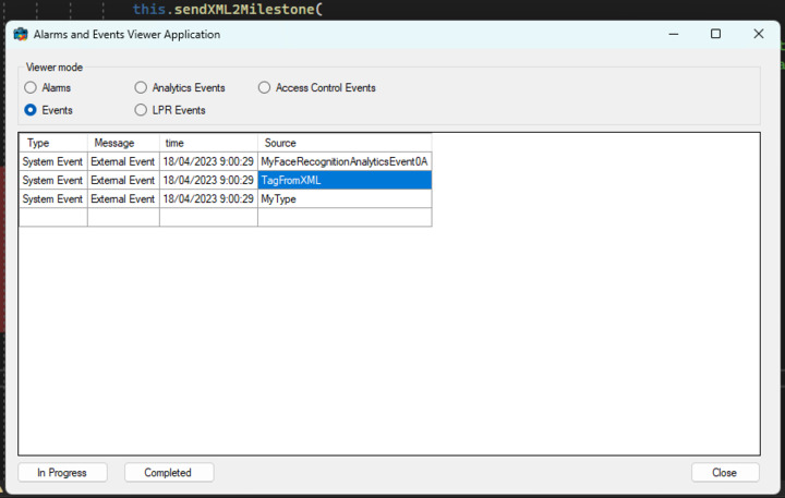

Alarm and Event Viewer sample might be helpful, please see this link -
https://doc.developer.milestonesys.com/html/index.html?base=samples/componentsamples/alarmeventviewer/readme.html&tree=tree_2.html
And ref. https://doc.developer.milestonesys.com/html/index.html?base=gettingstarted/intro_events.html&tree=tree_4.html

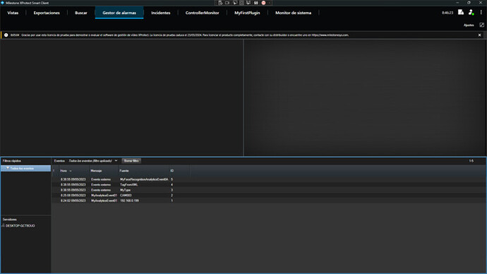

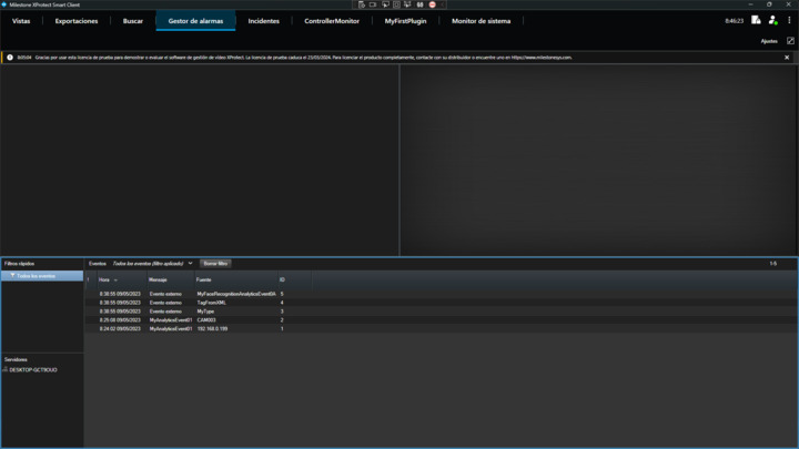

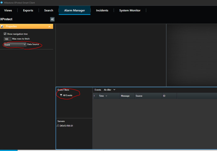

I have tested the Application that you referred to and checked the outcome of the Event I sent to Milestone:

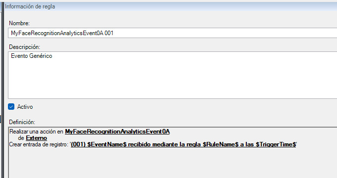

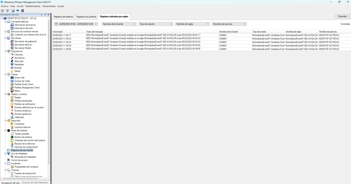

As you can see, I can see that an event has been sent to Milestone,
but I could see that also in the Milestone Log using a rule I created for that:

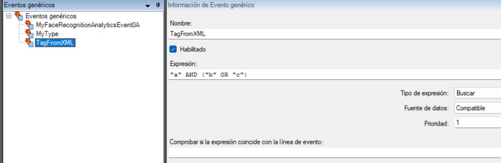

Even if I switch the name of the tags and in the XML:
MyTypeFaceRecognitionEvent
MyFaceRecognitionAnalyticsEvent0A
CustomTagFromXML01
They do now show up in the application that you mentioned.

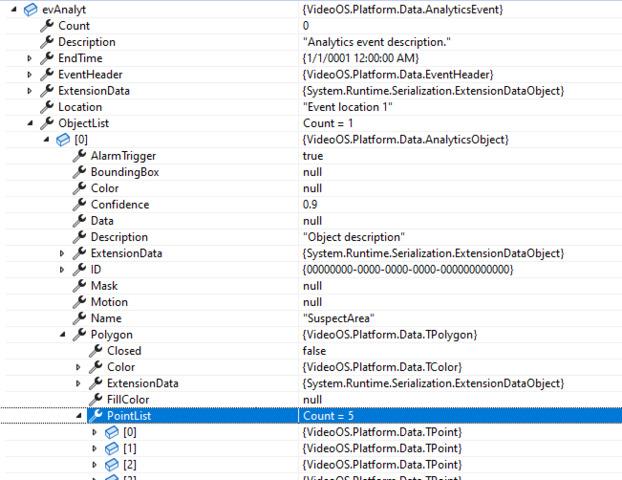

Please put a break point on the line 94 around (see // Break point HERE in below code) in OverlayGraphOnEventBackgroundPlugin.cs
private object NewEventIndicationMessageHandler(VideoOS.Platform.Messaging.Message message, FQID dest, FQID source)
            try
                AnalyticsEvent evAnalyt = message.Data as AnalyticsEvent;
                if (evAnalyt != null)
                    DrawGraphOverlays(evAnalyt);  // Break point HERE
You will see evAnalyt – ObjectList - Items[0] - Polygon.PointList. That is what you can get from an analytics event when you trigger it.

I have checked what you mentioned about line 94
If I use the Smart Client Overlay Graph on Event sample with the application AnalyticsEventTriggerViaLibrary , the flow of the program stops in that line as you mentioned, and I can check the data that there is in that ObjectList.
But, when I send a complete XML using my own function:

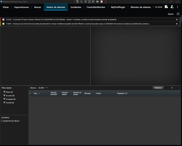

Can we get one step back? Can you please verify if you can see your events that you trigger? We would like to know if you can get them properly and can see them on Smart Client.
Please start Smart Client and go to Alarm Manager tab, then you will see all events that you trigger.
Sure thing
No Alarms, no triggers in this screen
But if I call with AnalyticsEventViaLibrary , since I have kept that breakpoint in line 94, it stops there.
Even when I select the Alarm Manager tab, it stops at that same breakpoint.

I have modified the file OverlayGraphOnEventBackgroundPlugin.cs to add other possibilities:
Code Section 1:
            try
                MyAnalyticsEvent myEvAnalyt = message.Data as MyAnalyticsEvent;
                if (myEvAnalyt != null)
                    DrawGraphOverlays(myEvAnalyt);
                BaseEvent baseEvent = message.Data as BaseEvent;
                if (baseEvent != null)
                    // Habría que extraer los datos en caso de que se recibiera un tipo básico de Evento
                    // Esto sucede cuando se manda un XML directamente
                    DrawGraphOverlays(baseEvent);
            catch (Exception ex)
                EnvironmentManager.Instance.ExceptionDialog("NewEventMessageHandler", ex);
            return null;
Because I relized that, when I send the proper XML file that I have generated myself, with the function:
Code Section 2:
string response = SendXmlWithSocket(
                          faceRecognitionXml,
                          destinationAddress_param,
                          Convert.ToInt32(destinationPort_param)
I receive an object of type BaseEvent in the SCOverlayOnEvent sample for the Client.
But the data received in that function is empty, there is no ObjectList that could contain my custom data, so I cannot access it either
In the Code Section 1, you can see that I have also added the chance of the data being a MyAnalyticsEvent object, which is the one that is an AnalyticsEvent object modified to contain the data I require.

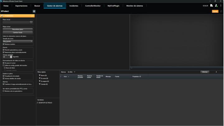

Let’s focus on one thing at a time. Firstly, let’s forget about your code and samples. Please verify that Event functionality works and see the events that you trigger. Otherwise, your code never works.
When looking at your image of Smart Client, it seems to me, you are looking at Alarm list, not Event list.
Please start Smart Client and go to Setup and select Event on the left (see the question link that we provided, there is an image and instructions..)
​If the event list on SC will be still empty when you trigger a test event (on Management Client), then I believe that is not a SDK issue, rather installation/setup issue. However I am not 100% sure if it is not SDK, so again, please read the previous link and follow the instructions there. And please send images that you setup.
I have the application installed in Spanish for consistency with my colleagues at the company
I do not know if it is possible to change the language of the Milestone application while running it to send you screenshots in English.
As I can see, the older the trigger, the lower it is in the list.
First Trigger:
Message: MyAnalyticsEvent01
Source: 192.168.0.199
Generated using the TriggerAnalyticsEventXML application
Second Trigger:
Source: CAM03
Generated using AnalyticsEventTriggerViaLibrary
Third to Fifth Triggers:
These Elements are generated by my code:
Third Trigger:
Message: External Event
Source: MyType
Fourth Trigger:
Source: TagFromXML
Fifth Trigger:
Source: MyFaceRecognitionsAnalyticsEvent01
These three, have those sources (MyType, TagFromXML, MyFaceRecognitionsAnalyticsEvent01) because they are defined in my Generic Events.
But they are not found by SCOverlayGraphOnEvent, even if I added the code for different objects

This way, when we send the Analytics Event object to the server:
AnalyticsEvent analyticsEvent = new AnalyticsEvent();
EnvironmentManager.Instance.SendMessage(
  new VideoOS.Platform.Messaging.Message
    (MessageId.Server.NewEventCommand)
    { Data = analyticsEvent }
And, as it is received, it is shown in the Client Alarm Management:
But the event is not received on the Milestone Server:
