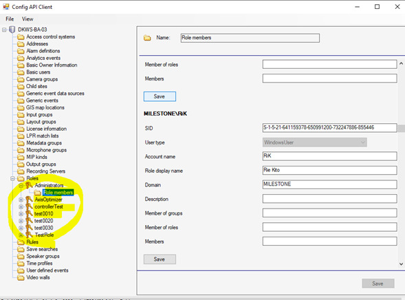

ConfigAPI Client sample might be helpful for you. https://doc.developer.milestonesys.com/html/index.html?base=samples/componentsamples/configapiclient/readme.html&tree=tree_2.html
Please read this link - https://doc.developer.milestonesys.com/html/index.html?base=gettingstarted/intro_configurationapi.html&tree=tree_4.html which also include info on login(Login and authentication process).
Hi Rie,
Yep, I already found it, and it is super useful project!! Anyway, I’m trying to found the reference on how to use this SOAP service, and obtain all of the endpoints with possible parameters.
