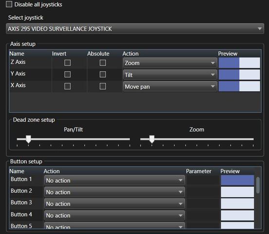

I don’t understand that the joystick events are not accessible but I can monitor the button status when looking at the joystick settings in SC. See the capture of button #1 when pressed… How is this being done?
The picture you showed us is the settings on Smart Client and it is possible to configure in SC. But there is no public methods for listening to the joystick events received by the Smart Client on MIP SDK unfortunately.
