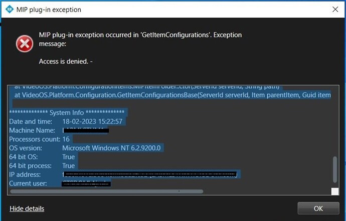

I am getting exception and Smart client crashes after my pc Idle for a long time Pls Help
Clinet Log

I am Using Milestone version 2022R3 and MIPSDK Version also 2022R3.
My Smart client crashed when system is idle for a long time. Pls Help
