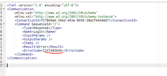

I found another problem:
I’m working with 2022R1, getting connection string for a while, everything is okay.
but after a while, I get one of these 2 errors when I try to get connectionString without any change.
1)“The processing instruction target matching \”[xX][mM][lL]\" is not allowed."
2)I checked this error number, you don’t have this error number in your document and as I can see it looks like some unhandled error becausethe error code gets the default value I guess.
Let me know if u need some logs from the server or …
