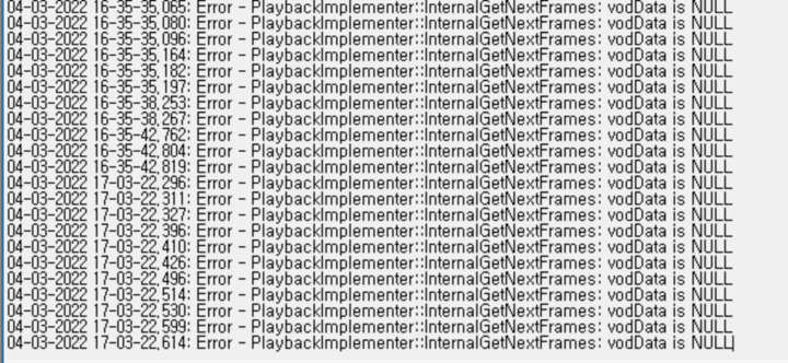

I expected a video from 11:11:11, but the live video was played.
So, I found the latest rtsp log.
Plase tell me what I need to fix. ​
