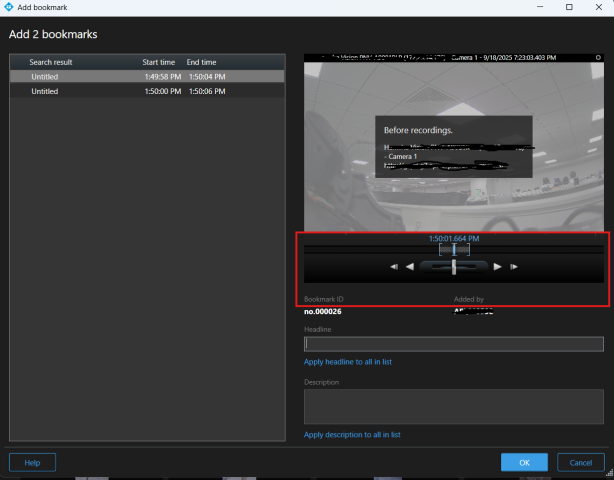

I am developing my plugin that create a bookmark identical to Milestone Bookmark popup up.
For that I need a playback control similar to Add Bookmark playback control for my plugin which allows user to select the timeline and Start time and End time adjust accordingly.
Can you guide me how to achieve this using SDK?
The control in the picture you have is not in the MIP SDK. Another similar control is.
