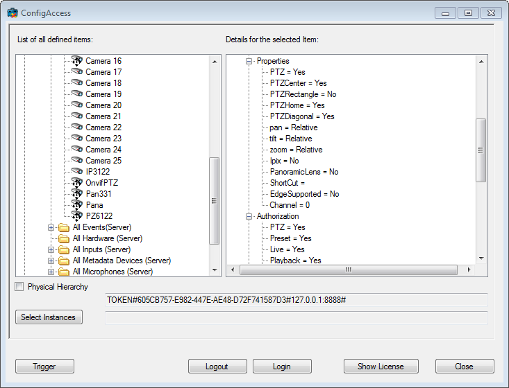

The information is part of the configuration data. The best way to explore this is to run the ConfigAccessViaSDK sample. In the sample pick the camera and see the Properties (and the Authorization) information in the right hand panel.
