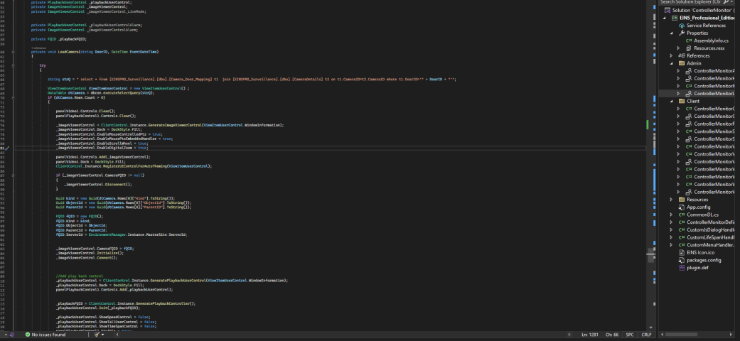

I am currently working on integrating the camera view feature into the Admin panel using a plugin, and the code is functioning as expected when used in the XProtect Smart Client. However, when I try to run the same code in the XProtect Client, I encounter the error message: “Not Supported for this Environment.”
I have attached a screenshot for your reference, showing the exact error. Could you please advise on the necessary code changes or configuration adjustments to ensure compatibility with the XProtect Client environment?
The screenshot does not show an error.
