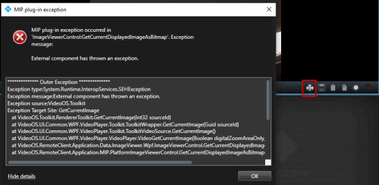

We are using imageviewer control and when we click print initially even after handling exception by putting try/catch block still we receive exception

  catch(Exception)
error windows
stack trace
************** Outer Exception **************
Exception type:System.Runtime.InteropServices.SEHException
Exception message:External component has thrown an exception.
Exception source:VideoOS.Toolkit
Exception Target Site: GetCurrentImage
at VideoOS.Toolkit.RendererToolkit.GetCurrentImage(Int32 sourceId)
at VideoOS.UI.Common.WPF.VideoPlayer.Toolkit.ToolkitWrapper.GetCurrentImage(Guid sourceId)
at VideoOS.UI.Common.WPF.VideoPlayer.Toolkit.ToolkitVideoSource.GetCurrentImage()
at VideoOS.UI.Common.WPF.VideoPlayer.VideoPlayer.VideoGetCurrentImage(Boolean digitalZoomAreaOnly, Boolean includeImageOverlays)
at VideoOS.RemoteClient.Application.Data.ImageViewer.Wpf.ImageViewerControl.GetCurrentDisplayedImageAsBitmap(Boolean digitalZoomAreaOnly)
at VideoOS.RemoteClient.Application.MIP.PlatformImageViewerControl.GetCurrentDisplayedImageAsBitmap(Boolean digitalZoomOnly)
************** System Info **************
Date and time: 5/5/2020 9:21:16 AM
Processors count: 16
OS version: Microsoft Windows NT 6.2.9200.0
64 bit OS: True
64 bit process: True
Please help to solve
