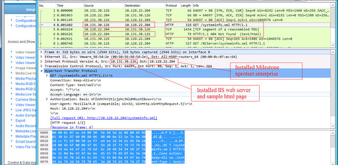

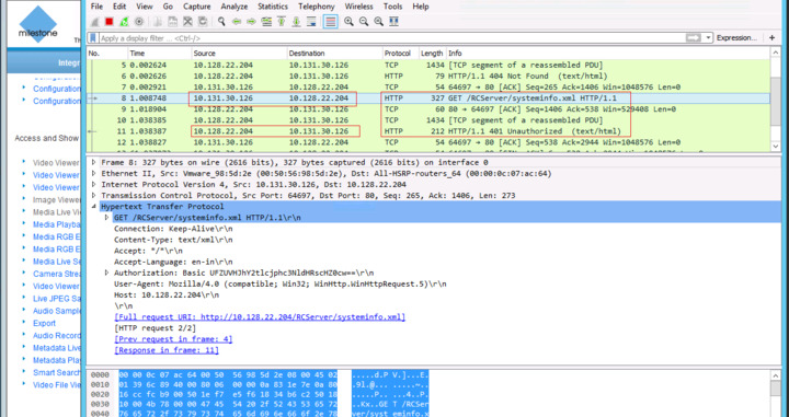

Thank you for your quick response. Still we are facing the same problem and tried wireshark to capture network traffic and packets, we found 404 (Not found) and 401(Unathorized) status. we are using basic authentication, in case we enter wrong username and password we are getting an error message “Unable to connect server”. If we enter right credentials there is no issue and selected engine dropdown will be enabled as shown in the above screen shot but engine list is empty. As you suggested we tried wireshark but could not trace out the actual problem. Please find below screen shots and help us to solve the issue. If possible, please share support contact number in India to communicate over phone.

I see in the trace that no systeminfo.xml is returned, please test without the sample in this way -
