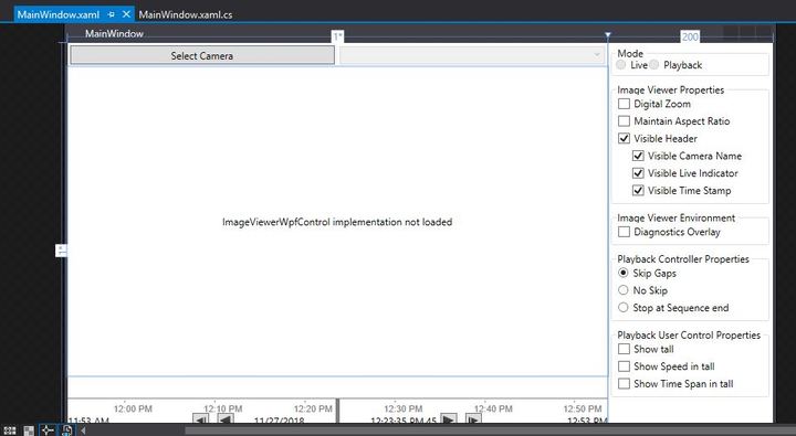

This happened to me as well, I just build and start the project PlaybackWpfUser from Milestone/componentSamples unmodified, it still show ImageViewerWpfControl implementation not loaded, even in preview mode.
I have already downloaded and installed both the x64 and x86 MIPSDK restributable but the problem still exists.
