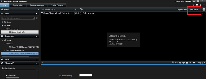

In smartclient, how open Form with button in menu, like Setting button, that popup window with config?

So, I explain my problem better. I created a button on the toolbar, and I would like a form to open as soon as I click on the button. I would like an example, because I’m trying and I don’t understand how to do it.
I have this:
 Public Overrides Sub Activate()
' Here you should put whatever action that should be executed when button is pressed
MessageBox.Show("First toolbar button clicked")
End Sub

mm.. I saw it, but it change color.. so is no ok for me.
with this code:
    MessageBox.Show("First toolbar button clicked");
when I click I see popup mesage.. but I dont know, how I can see popup form..
Other idea? :frowning:
