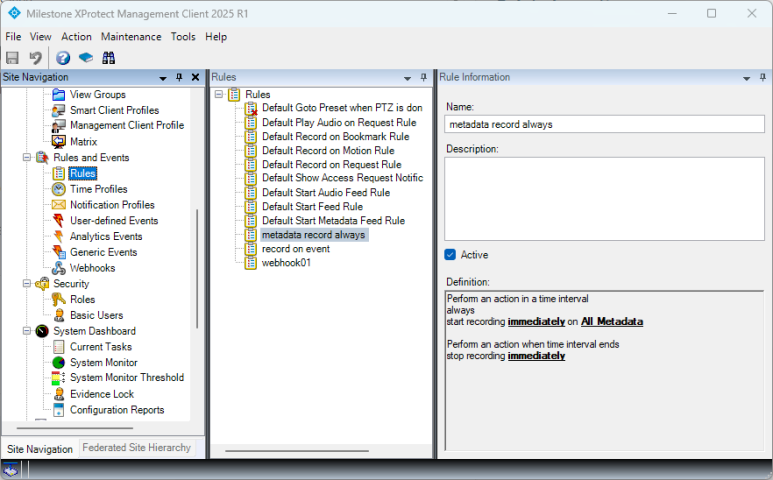

My first suspicion is that all is working fine except the metadata is not recorded. Using only default rules the metadata provider is recorded unless it is associated with a camera which is recorded. If my assumption is right you will get the metadata if you use the MetadataLiveViewer instead.
For your testing please create a ‘RecordAlways’ rule looking something like this.
