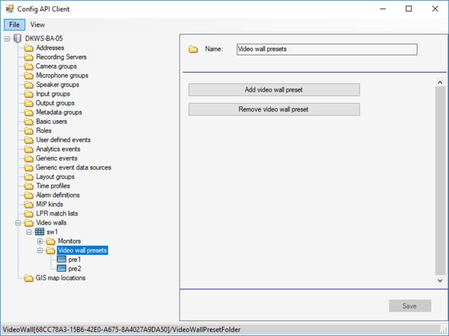

Is creating new VideoWallPreset available in latest MIPSDK (2019R1) ?
Yes it is. You can create a vide wall preset using the configuration API. See how it looks in the Config API Client sample.

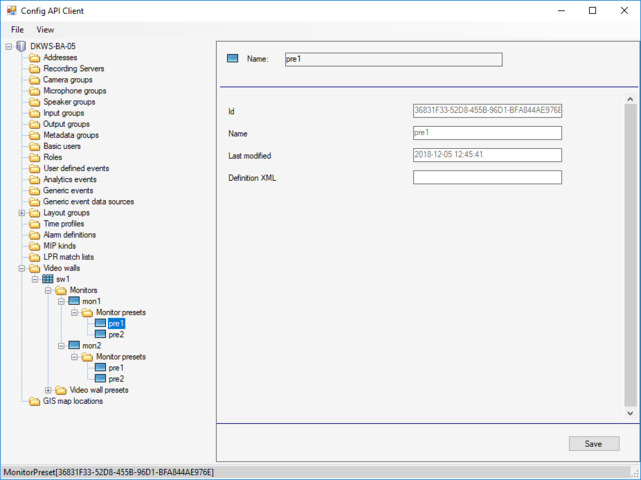

When a preset has been created you can find it under each of your Smart Wall monitors:
The Config API Client does unfortunately not display the field Defintion XML, but you can mark it all (Ctrl+A), copy it (Ctrl+C) and then paste into Notepad or another editor. I actually imagine that you will develop your own code to read and/or write this.
There is no implementation in the MIP SDK that can help you create a new valid Definition XML, but you might be able to reuse some XML created from an example and do alterations to the XML.
